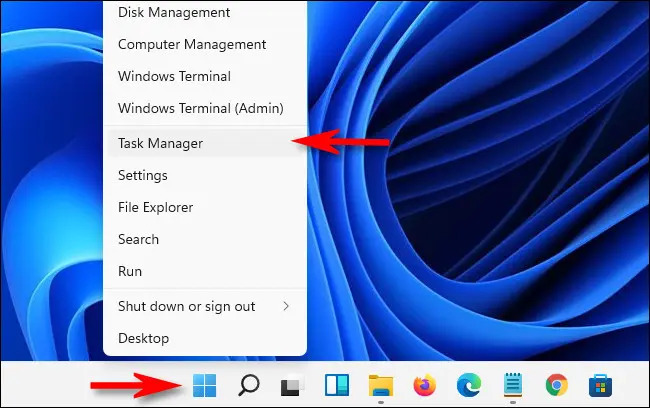

There are multiple ways to do this:
  • Right-click the Windows Start button (on the taskbar at the bottom of your screen), then click "Task Manager" in the context menu, or
  • Press Ctrl + Shift + Escape simultaneously.

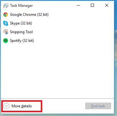

Step 2: Expand the Task Manager Window
Once Task Manager opens you may see a simplified view. To access the full view, click "More details" in the bottom-left corner of the window.

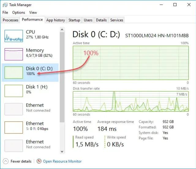

Step 3: Examine Your Components' Performance
In the expanded Task Manager, select the "Performance" tab. Here you'll see your computer's components — CPU, memory (RAM), and disk. Check if any of these are at or near 100% utilization — that's usually the source of a slow PC.

Issue: Disk at 100%
If your drive sits at 100% utilization, run a S.M.A.R.T. health check with CrystalDiskInfo or HD Tune. If the drive is failing, replace it — back up your data immediately. If you're still on a spinning hard drive, installing a solid-state drive (SSD) is the single biggest performance upgrade you can make to an older PC.
